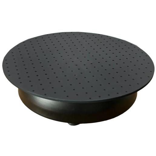

- TurnTable 50
TurnTable for automated positioning of objects to be measured / digitized:
- Automatic merging of single scans
- Hole grid plate pre-drilled with M6 threaded holes for fixing elements
- Pre-definable turn angle positions
| Product Type | Accessory |
| Compatibilità del sistema | PrimeScan SmartScan SmartScan VR800 StereoScan |
| Dimensions | 480 x 480 x 115 mm |
| Power Supply | DC 24V / 2A |
| Base Plate Diameter | 480 mm |
| Turn Angle | 360 ° |
| Speed | 2 RPM |
| Interface | USB 2.0 |
| Load Capacity | up to 50 kg |
| Peso | 7 kg |
