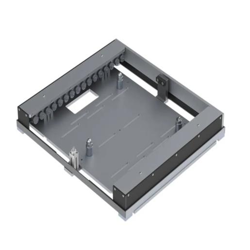

The Lightweight Kinematic manual loading system enables easy component loading of the CMM by the operator.
Features
- Pallet Size: 400 x 400 mm
- Max. component weight: 50 kg
- Qualification sphere area allowing tip qualification without the need to remove the loading system from the CMM.
- Pneumatic lifter lowers the pallet onto fixed kinematic locators for repeatable part positioning.
- Compressed air supply: 6 bar
- Stopper Cylinder ensure the pallet cannot be pushed into the kinematic area if the rollers are in the lowered position.
- Plastic rollers for contact with the loading pallets
Image for illustration purpose only and may differ from the product.
| Product Type | Manual Pallet System |
| Trolley Compatibility | Trolley System 400 x 400 mm (GB0120-2005) |
| Base Plate Compatibility | KPP-400/400 KPT-400/400 |
| Max. Component Weight | 50 kg |
