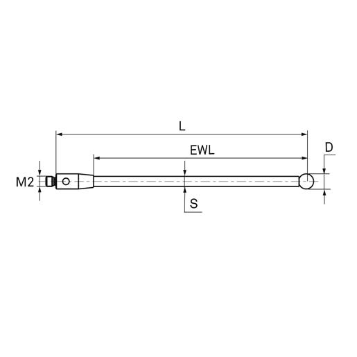

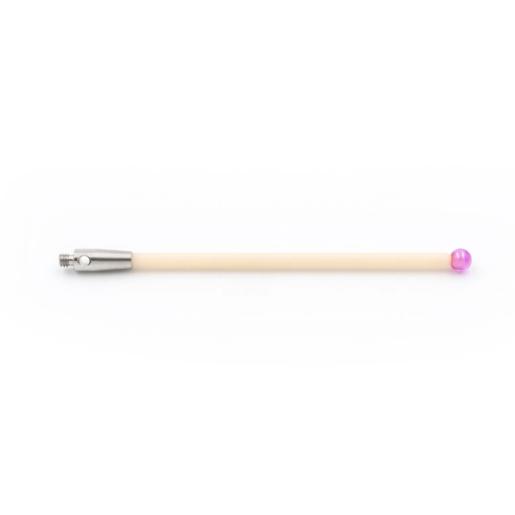

Straight stylus with M2 thread, ruby ball Ø3 mm, ceramic stem Ø2 mm, length 50 mm. For use on coordinate measuring machines (CMM).
The stylus is an important part of the measuring system. During the measurement, the stylus is in direct contact with the part.
Straight styli are the most common type used in the metrology industry. Depending on the application, different materials for stems and tips are available.
Ruby is the most widely-used material for styli tips. Thanks to its inexpensive price and high quality, it is the standard choice for most applications. It is an extremely hard material, which tends, however, to cause material build-up when combined with certain materials such as aluminium.
A ceramic stem is characterised by its light weight and high stiffness. Additionally, ceramic stems will break in a collision and can therefore protect sensors from damage.
Renishaw Code A-5003-0064
Závi M2
Zařízení SMS
Materiál kuličky Rubín
Průměr zakončení (D) 3 mm
Stupeň přesnosti kuličky G5
Délka (L) 50 mm
Efektivní činná délka (EWL) 47 mm
Materiál dříku Keramický
Průměr dříku (S) 2 mm
Hmotnost 0,8 g
