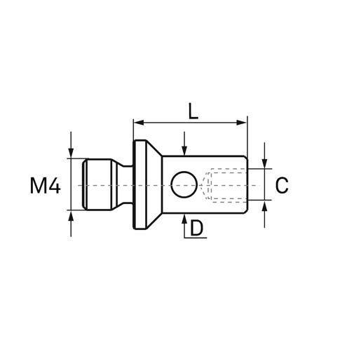

Stainless steel stylus adapter with male thread M4 and female thread M3
Hexagon styli accessories enables the user to create flexible and individual probing configurations to measure complex geometries and difficult to reach characteristics.
Adapters are used to adapt the stylus to other threads or accessories.
Similar to Renishaw Code A-5004-7597
Related Device CMM
Male Thread M4
Female Thread (C) M3
Diameter (D) 4.5 mm
Length (L) 9 mm
Material Stainless Steel
Weight 1.3 g
