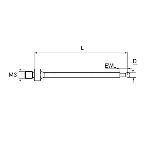

Straight stylus with M3 thread, ruby ball Ø2 mm, stainless steel stem (stepped) Ø1/2 mm, length 39.5 mm. For use on coordinate measuring machines (CMM).

| Part Number | M00-1121-026-000 |
| Device | CMM |
| Thread | M3 |
| Tip Material | Ruby |
| Tip Diameter (D) | 2 mm |
| Ball Grade | G5 |
| Length (L) | 39.5 mm |
| Eff. Working Length (EWL) | 3.2 mm |
| Stem Material | Stainless Steel |
| Stem Diameter (S) | 1.0 / 2.0 mm |
| Weight | 1.5 g |
