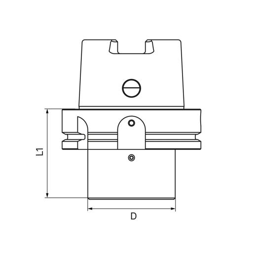

Hollow taper shank HSK100 Form A for use with Hexagon touch probes with D28 connection and mechanical activation in the machine tool.
Available quantity is .
Backorder eligible quantity is .
Do you wish to continue?
This product is currently not in stock. You can still add to cart, this will be considered as backorder. Do you want to continue?
Hexagon original accessories for measuring systems in the machine tool ensure maximum precision and reliability in production. The shank establishes a secure connection between the touch probe and the spindle in the machine tool. Hexagon offers a wide range of shanks for various interfaces and different probe activation methods.
Interface
  • D28
Shank Activation Method
  • Mechanical: The probe is activated by a mechanical switch inside the HSK. The probe is switched on in the spindle and switched off in the magazine.
  • Mechanical: IRP25.10, IRP25.41, IRP25.44, IRP25.50, RWP20.10, RWP20.41, RWP20.44, RWP20.50-G, RWP20.50-M
  • Bidirectional: IRP25.50, RWP20.50-G, RWP20.50-M, LS-R-4.8
Extended probe configurations are possible by using suitable adapters
Probe Compatibility with Modular Adapter D20-MO-B and probe activation
  • Bidirectional: IRP40.01, IRP40.02, IRP40.40-LF, IRP40.42, TP-R-400
Probe Compatibility with Modular Adapter D20-MO-B-D50 and probe activation
  • Bidirectional: RWP38.41
Probe Compatibility with Modular Adapter D20-MO-A/W/M/P and probe activation
  • Mechanical: IRP32.00, RWP38.10
Probe Compatibility with Modular Adapter 5942 and probe activation
  • Bidirectional: IRP60.00
Part Number D28-HSK100A-M
Product Type Hollow Taper Shank (HSK)
Interface D28
Activation Method Mechanic (M)
Shank Standard DIN 69893-1
Shape
Diameter (D) 63 mm
Length L1 65 mm
