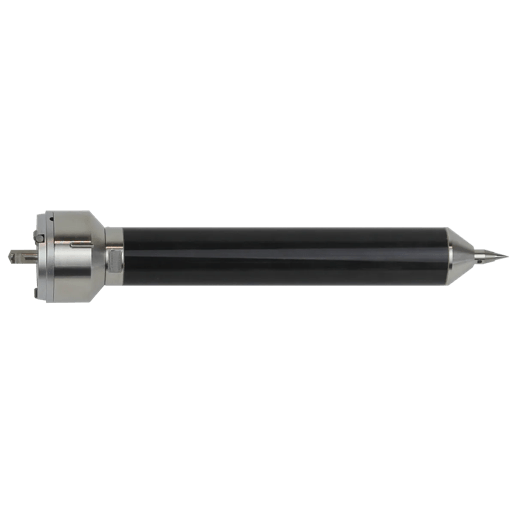

130 mm carbon probe with mounted M3-Pointer Stylus. For use with all Absolute Arm models.
Toegevoegd aan uw winkelwagen.
Probes are used on portable measuring arms to allow for the single-point touch measurement of surfaces and features.
This carbon probe has a body length of 130 mm. It will be delivered with a mounted pointer stylus with M3 thread.
Compatible with all Absolute Arm models with a TESA kinematic joint connector.
Lengte | 130 mm |
Tasterverbinding | TKJ mannetje |
Stylus montage | M3 |
Behuizings materiaal | Koolstofvezel |
Taster diameter | 16 mm |
Styli Tip Type | Punt |
Kogel materiaal | Wolfraamcarbide |
Gewicht | 78 g |
