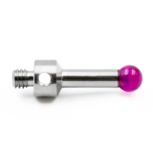

Straight stylus with M4 thread, ruby ball Ø5 mm, stainless steel stem, length 17.5 mm. For use on machine tools. Previous part number: 91.00-T20/5-ST-M4-D7
The stylus is an important part of the measuring system. During the measurement, the stylus is in direct contact with the part. Straight styli are the most common type used in the metrology industry. Depending on the application, different connections, materials for stems and tips are available.
Ruby is the most widely-used material for stylus tips. Thanks to its inexpensive price and high quality, it is the standard choice for most applications. It is an extremely hard material.
A stainless steel stem provides high stiffness and is ideal where weight is not critical for the application.
Previous Part Number 91.00-T20/5-ST-M4-D7
