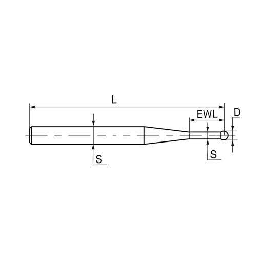

Straight stylus with Ø2 mm, silicon nitride ball Ø1 mm, tapered tungsten carbide stem Ø0.8/2 mm, length 22 mm. For use on coordinate measuring machines (CMM).

The stylus is an important part of the measuring system. During the measurement, the stylus is in direct contact with the part.
Straight styli are the most common type used in the metrology industry. Depending on the application, different materials for stems and tips are available.
Silicon nitride styli tips have similar material properties to ruby whilst being more wear-resistant. Silicon nitride does not tend to form material build-up while scanning. Because of this, it is recommended for measurements on aluminium parts.
A tungsten carbide stem has high stiffness and less thermal expansion, compared to stainless steel.

Filetto / Collegamento | D2 |
Materiale punta | Nitruro di silicio |
Diametro punta (D) | 1 mm |
Classe sfera | G5 |
Lunghezza (L) | 22 mm |
Lunghezza di lavoro eff. (EWL) | 4 mm |
Materiale stelo | Carburo di tungsteno |
Diametro stelo (S) | 0,8 / 2,0 mm |
