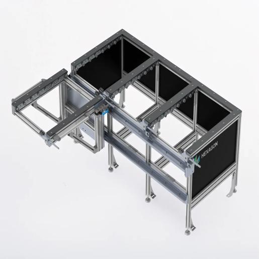

The 3-pallet shuttle system enables users to manually transfer a baseplate from any of the three loading/unloading stations to the CMM via the Kinematic Manual pallet system. By allowing components to be loaded or unloaded at two stations while the CMM inspects components from the third station, the shuttle system effectively reduces downtime and maximises productivity.
Features
- Pallet Size: 500 x 750 mm
 - Loading slots: 3
 - Max component weight: 150 kg
 - Movable shuttle for loading the CMM from the storage stations
 - The stage is aligned with the manual loading system on the CMM granite
 - Stage locks in place when either loading/unloading the CMM or pallet bays
 - Loading and storage bay are equipped with manually operated stops to prevent pallets from moving when the shuttle is not in the correct position
Image for illustration purpose only and may differ from the product.
| Product Type | Shuttle System |
| Pallet System Compatibility | Heavy-duty Manual Pallet System 500 x 750mm (GB0119-2000) |
| Base Plate Compatibility |
							GB0119-2005  GB0119-2006  |
| Max. Component Weight | 150 kg |
