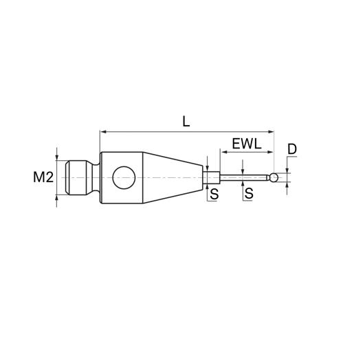

Straight stylus with M2 thread, ruby ball Ø0.5 mm, stepped tungsten carbide stem Ø0.36/0.7 mm, length 10 mm. For use on coordinate measuring machines (CMM).

| Schroefdraad | M2 |
| Kapcsolódó eszköz | CMM |
| Kogel materiaal | Robijn |
| Kogel diameter (D) | 0.5 mm |
| Kwaliteit Kogel | G5 |
| Lengte (L) | 10 mm |
| Eff. Werk lengte (EWL) | 3 mm |
| Schacht materiaal | Wolfraamcarbide |
| Schacht diameter (S) | 0.36 / 0.7 mm |
