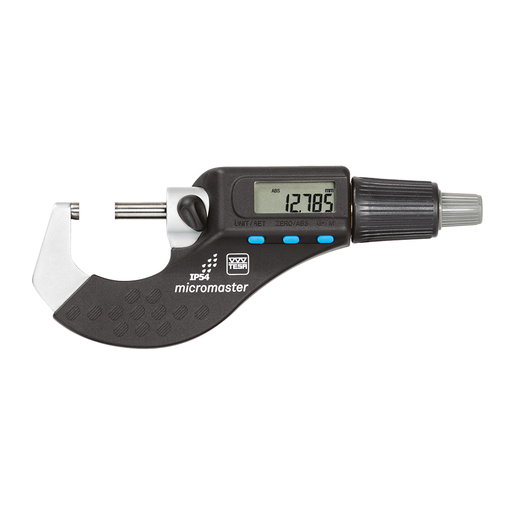

Digital external micrometer with data transmission. Measuring range: 0 - 30 mm / 0 - 1.2 in
Added to your shopping cart.
Instrument
- Robust construction to ensure long life and stable results
- High degree of protection against liquids and dust
Measurement
- Comfortable reading with large high contrast display
Autonomy
- Long battery life avoiding frequent battery changes
Data Management
- Model with data transmission
Functions
- Standby after 10 min
- Display locking
Delivery contents
1x External Micrometer
1x Battery
1x Measurement report
1x Declaration of conformity
| Product Type | External Micrometers |
| Measurement Technology | Digital |
| Measuring Unit | mm / in |
| Measuring Range | 0 - 30 mm / 0 - 1.2 in |
| Resolution | 0.001 mm / .00005 in |
| Measuring Force | ≤ 10 N |
| Max. perm. Errors | 4 µm |
| Max. perm. Parallelism Error | 2 µm |
| Protection Class |
IP54 IP40 (with Opto-RS232) |
| Thread Pitch | 0.5 mm |
| Dimension (A) | 163 mm |
| Dimension (B) | 66 mm |
| Dimension (C) | Ø 6.5 mm |
| Dimension (D) | 22 mm |
| Standard | DIN 863 T1 |
| Battery | CR2032 |
| Autonomy | 2,000 - 4,000 h |
| Zero | Floating |
| Data Output | Opto-RS232 |
| Display | LCD, Digit Size: 7 mm |
| Material | Inserts: Tungsten Carbide |
| Weight | 277 g |
