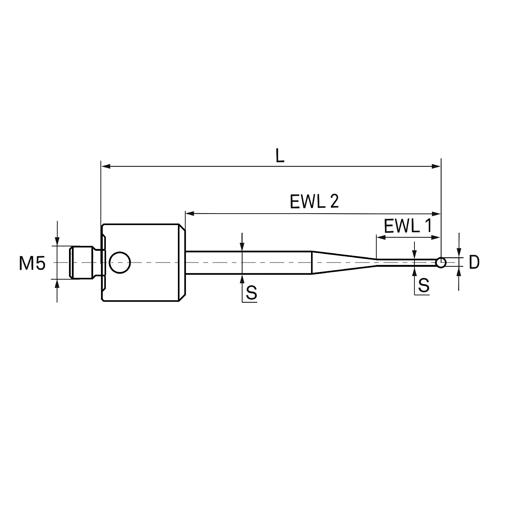

- M5-Stylus (R-1.5-TC-1/3.5-L53) - Tapered
N° :
M00-694-150-019
€157.00
Prix Net hors frais de port
Les prix ne sont valables que pour les commandes passées via la boutique en ligne
En stock - Livraison sous 1 à 2 jours
Vue d'ensemble sommaire
Straight stylus with M5 thread, ruby ball Ø1.5 mm, tapered tungsten carbide stem Ø1/3.5 mm, length 53 mm. For use on coordinate measuring machines (CMM).
Ajouté au panier.
The stylus is an important part of the measuring system. During the measurement, the stylus is in direct contact with the part.
Straight styli are the most common type used in the metrology industry. Depending on the application, different materials for stems and tips are available.
Ruby is the most widely-used material for styli tips. Thanks to its inexpensive price and high quality, it is the standard choice for most applications. It is an extremely hard material, which tends, however, to cause material build-up when combined with certain materials such as aluminium.
A tungsten carbide stem has high stiffness and less thermal expansion, compared to stainless steel.
