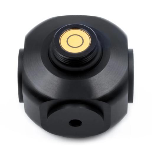

Cross adapter for the connection of up to 5 measuring units to one machine tool probe.
Añadido a la cesta de la compra.
With the cross adapter 41.00-KA, up to 5 measuring units (41.00-PP# or 21.00-MY#) as well as measuring unit extensions can be mounted to one machine tool probe. Not used connections must be covered with screw plugs. 4 screw plugs are in the delivery contents.
Dispositivo | Máquina herramienta |
Material | Aluminio |
Compatibilidad |
PP21.00 PP41.00 |
Internal Thread | 5x M16x1 |
External Thread | M16x1 |
