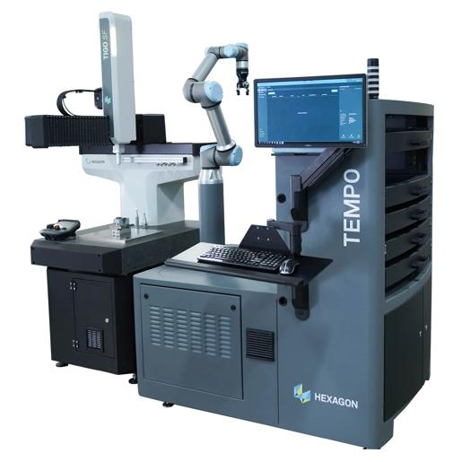

TEMPO
TEMPO is the cost-effective automated part loading system that increases the throughput of your coordinate measuring machine (CMM) and maximises operational capacity. It enables autonomous measurement free from interruption. Whether you have overnight production requirements or staff need to switch their focus to other important tasks, TEMPO allows manufacturers to maintain output even when CMM operators are unavailable. TEMPO works any extra shifts, anytime.
Machine condition
- Demo machine
Year of manufacture
- 2020
Further technical information
- TEMPO: Download Datasheet
Delivery contents
- Drawer Cabinet: 3 drawers (default), each with configurable mounting plate and dowel pin kit
- Robot: Universal Robots, UR5e collaborative
- Gripper: Robotiq, Hand-E two-finger gripper, Robot Calibration Tool
- Software: TEMPO dedicated system software, Interface to configure part & fixture, schedule measurement process, check which are out of tolerance, etc.
- CMM Fixture Assembly with vise: Standard system
