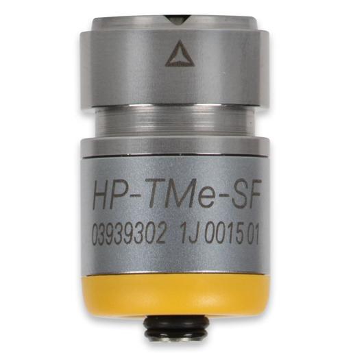

Standard force probe module of the compact 5-way touch trigger probe HP-TMe.
The HP-TMe is a compact 5-way touch trigger probe. The two piece design is comprised of the probe body and a detachable module. The body and module are connected together by a highly repeatable kinematic magnetic coupling. The modules can be quickly changed either manually or automatically without the need to recalibrate the probe.
The probe modules are available in four versions each giving a different trigger force. The HP-TMe system can be easily retrofitted and is compatible with existing touch trigger controllers, extension and accessories.
This article contains the standard force probe module of the compact 5-way touch trigger probe HP-TMe, which is designed for a wide range of applications with stylus lengths of up to 50 mm and small star stylus configurations. Further technical information can be found on the product website.
Dispositivo MMC
Previous Part Number 03939171
Sensor relacionado HP-TMe
Probing Directions ± X, ± Y, + Z
Rosca de punta M2
Max. Stylus Length 40 mm
50 mm (Carbon Fibre)
Compatibilidad de bastidores HR-P
HR-MP
Peso 11,5 g
