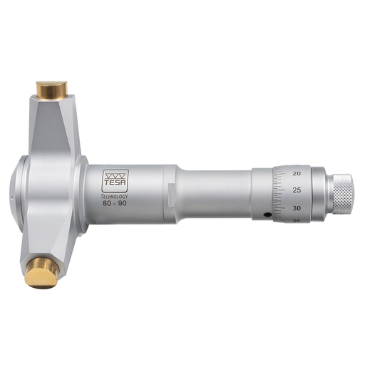

Analogue internal micrometer for the measurement of through bores. Resolution: 0.005 mm / Measuring range: 80 - 90 mm
Added to your shopping cart.
Instrument
- Robust construction to guarantee long life and stability of results over time
- 3 contact lines, Abbe's principle-compliant
- No influence of temperature variation on the measurement
- Comfortable reading with large, high-contrast display
Measurement
- For the measurement of through bores
- Auto-centering and auto-alignment
- Constant measuring force
Delivery Contents
1x Micrometer
1x Measurement report
1x Declaration of conformity
| Product Type | Internal Micrometers |
| Measurement Technology | Analogue |
| Measuring Unit | mm |
| Measuring Range | 80 - 90 mm |
| Resolution | 0.005 mm |
| Max. perm. Errors | 5 µm |
| Repeatability Limit | 5 µm |
| Dimension (A) | 11 mm |
| Dimension (B) | 12 mm |
| Dimension (C) | 84 mm |
| Standard | DIN 863 T4 / NF E 11-099 |
| Material | Measuring Face(s): Titanium nitride, hard-coated |
| Weight | 619 g |
