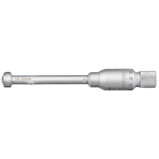

Analogue internal micrometer for the measurement of through bores. Resolution: 0.001 mm / Measuring range: 10 - 12 mm
Added to your shopping cart.
Instrument
- Robust construction to guarantee long life and stability of results over time
- 3 contact lines, Abbe's principle-compliant
- No influence of temperature variation on the measurement
- Comfortable reading with large, high-contrast display
Measurement
- For the measurement of through bores
- Auto-centering and auto-alignment
- Constant measuring force
