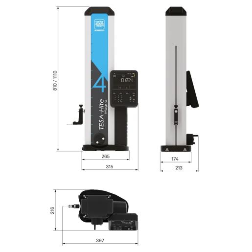

Panel
- Protected against the penetration of liquids or dust (IP65)
- Big colour screen for better reading in dimly lit surroundings
- Black display background for excellent contrast
- Large numbers displayed on the screen (21 mm) for optimal readability
- Keyboard with few buttons for easy learning without confusion
Autonomy
- Long battery life (60h) to avoid too frequent recharging
Measure
- Philosophy of use similar to tablets or smartphones
- Quick access to the first measurement from start up (<4s) for a significant time saving
- Magnetic measuring system ensuring functioning in the extreme conditions of the workshop
- QUICKCENTER DYNAMIC technology integrated to efficiently determine the culmination points
- Context-based online help to avoid incorrect use and bad results
- The interface can be customized according to the user's wishes
SCS Calibration Certificate
- Free SCS certificate provided to avoid additional costs for re-calibration at the initial purchase
Delivery Contents
1x Height gauge
1x Probe holder Ø 6 mm
1x Ball probe Ø 5 mm
1x Masterpiece
1x Power supply
1x User manual
1x SCS calibration certificate
1x Declaration of conformity
