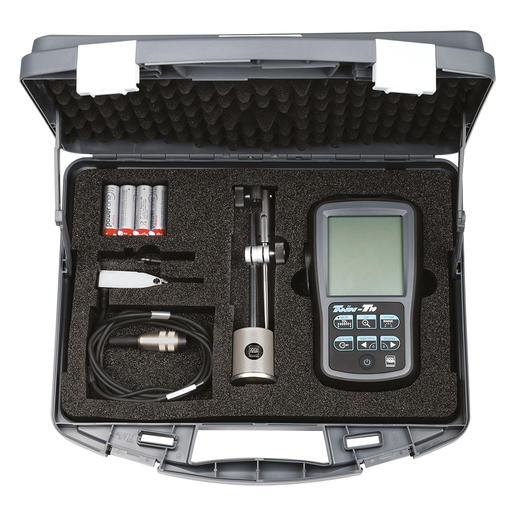

Portable set for quality control, consisting of a TWIN-T10 digital display unit, a GT31 lever probe and accessories.
TWIN-T10 Display
  • Large, high-contrast screen for clear and immediate reading
  • Retractable feet
  • Back mounting
  • Light and portable
  • Robust for use in any kind of conditions, even the most extreme ones
  • Powered by standard AA batteries only
  • Low consumption allows a long autonomy
  • Metric or imperial unit
  • Identification of values out of tolerance
  • Storage of MAX, MIN or MAX-MIN values during dynamic measurement
  • Combines analogue display and analogue indication
  • Zeroing of the display facilitating measurements by comparison
  • Special ZOOM display allowing a more detailed visualization of the analogue scale to facilitate precise adjustment
  • Up to 7 measuring ranges or automatic switching according to the measured value
Lever Probe GT31
  • Execution with inclinable lever
  • Ball-bearing balanced lever
  • One-piece housing provided with 2 dovetails
  • Inclinable probe insert through to 180°
  • Well suited for use where probes with measuring bolt moving lengthwise can not be conveniently operated
  • Inclinable probe insert for measuring in two directions
  • Interchangeable probe insert
  • Automatic reversal of the probing direction while that of the indication remains unchanged
  • Protected against shocks by 2 safety clutches
Delivery contents
1x TWIN-T10 Display (Part No. 04430013)
4x Batteries
1x Probe GT31 with lever, ± 0.3 mm, 0.1 N (Part No. 03210802)
1x Radial cable
1x Magnetic holder UJ15 (Part No. 01639007 )
1x Instruction manual including declaration of conformity
