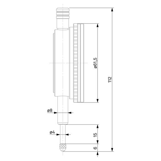

Analogue dial gauge Ø 61.5 mm, protection class IP40. With rotating dial and adjustable tolerance marks. Resolution 0.001 mm / Measuring range: 5 mm

| Measurement Technology | Analogue |
| Measuring Unit | mm |
| Measuring Range | 5 mm |
| Resolution | 0.001 mm |
| Travel / Revolution | 0.2 mm |
| Measuring Force | 1.4 N ± 20% |
| MPEe, retractable plunger | 10 µm |
| MPEp, 1 Rotation | 5 µm |
| MPEp, 1/2 Rotation | 4 µm |
| MPEp, 1/10 Rotation | 3 µm |
| MPEr | 0.5 µm |
| MPEh | 3 µm |
| Protection Class | IP40 |
| Insert Thread | M2.5 |
| Mounting shank Ø | 8 mm |
| Shockproof Mechanism | Yes |
