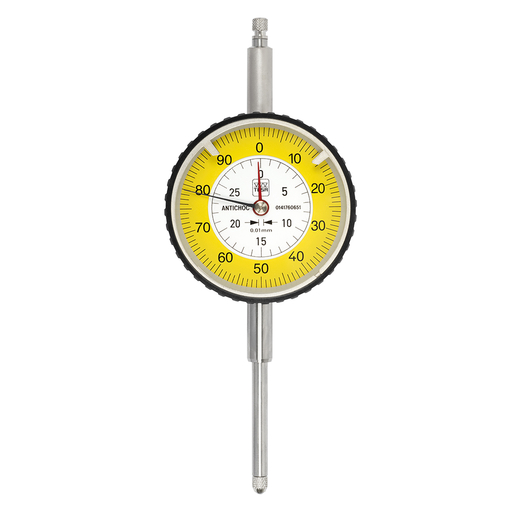

Analogue dial gauge Ø 58 mm, protection class IP40. With rotating dial and adjustable tolerance marks. Resolution: 0.01 mm / Measuring range: 30 mm

1x Dial gauge with mounted ball insert Ø 3.175 mm

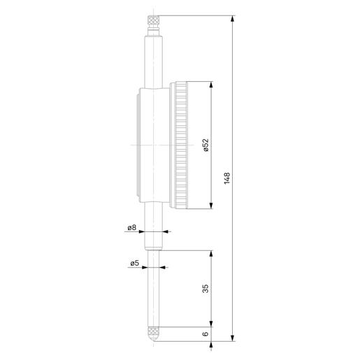

| Measurement Technology | Analogue |
| Measuring Unit | mm |
| Measuring Range | 30 mm |
| Resolution | 0.01 mm |
| Travel / Revolution | 1 mm |
| Measuring Force | 0.8 N ± 20% |
| MPEe, retractable plunger | 20 µm |
| MPEp, 1 Rotation | 15 µm |
| MPEp, 1/2 Rotation | 10 µm |
| MPEp, 1/10 Rotation | 5 µm |
| MPEr | 3 µm |
| MPEh | 5 µm |
| Protection Class | IP40 |
| Insert Thread | M2.5 |
| Mounting shank Ø | 8 mm |
| Shockproof Mechanism | No |

Dimensions: EN ISO 463 Performances: Factory standard |
