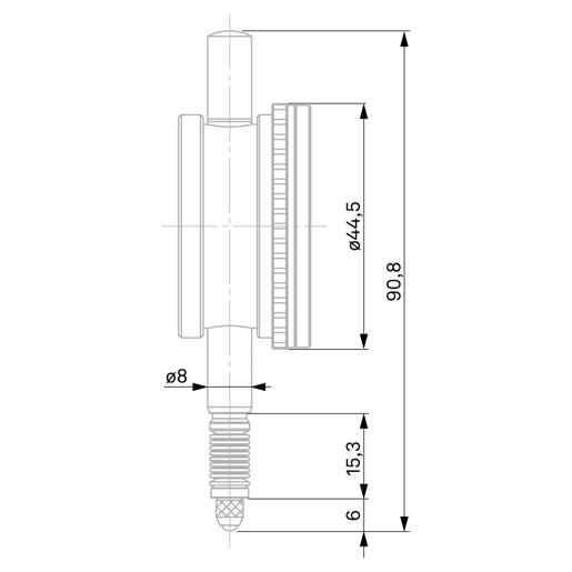

Cadran analogique Ø 44.5 mm, classe de protection IP67. Avec cadran rotatif et marques de tolérance réglables. Résolution : 0,01 mm / Etendue de mesure : 5 mm

| Measurement Technology | Analogue |
| Measuring Unit | mm |
| Measuring Range | 5 mm |
| Resolution | 0,01 mm |
| Travel / Revolution | 0,5 mm |
| Measuring Force | 0,9 N ± 20% |
| MPEe, retractable plunger | 12 µm |
| MPEp, 1 Rotation | 10 µm |
| MPEp, 1/2 Rotation | 9 µm |
| MPEp, 1/10 Rotation | 5 µm |
| MPEr | 3 µm |
| MPEh | 3 µm |
| Classe di protezione | IP67 |
| Insert Thread | M2.5 |
| Mounting shank Ø | 8 mm |
| Shockproof Mechanism | Si |
| Standard |
Dimensions: Factory standard Performances: DIN 878 |
| Dial |
Ø 44.5 mm, rotatable Moving tolerances indexes |
| Reading | Clockwise |
| Circular Scale | 0 - 20 - 50 |
| Colore |
Internal dial: White External dial: Yellow Numerals: Black |
| Materiale |
Casing: Metallic Mounting Shank: Stainless steel Plunger: Stainless steel |
| Peso | 138 g |
