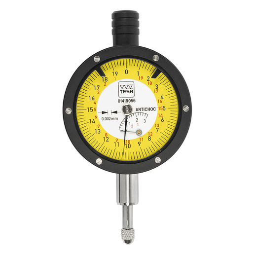

Analogue Dial Gauge, Ø44.5, 3 mm, 0.002 mm
ID:
01419056
zł1,397.28
zł1,136.00
Net price excluding delivery
Quick Overview
Analogue dial gauge Ø 58 mm, protection class IP40. With rotating dial and adjustable tolerance marks. Resolution: 0.002 mm / Measuring range: 3 mm
Added to your shopping cart.
Delivery contents
1x Dial gauge with mounted ball insert Ø 3.175 mm
1x Declaration of conformity
| Measurement Technology | Analogue |
| Measuring Unit | mm |
| Measuring Range | 3 mm |
| Resolution | 0.002 mm |
| Travel / Revolution | 0.2 mm |
| Measuring Force | 1.1 N ± 20% |
| MPEe, retractable plunger | 7 µm |
| MPEp, 1 Rotation | 5 µm |
| MPEp, 1/2 Rotation | 4 µm |
| MPEp, 1/10 Rotation | 3 µm |
| MPEr | 0.5 µm |
| MPEh | 3 µm |
| Protection Class | IP40 |
| Insert Thread | M2.5 |

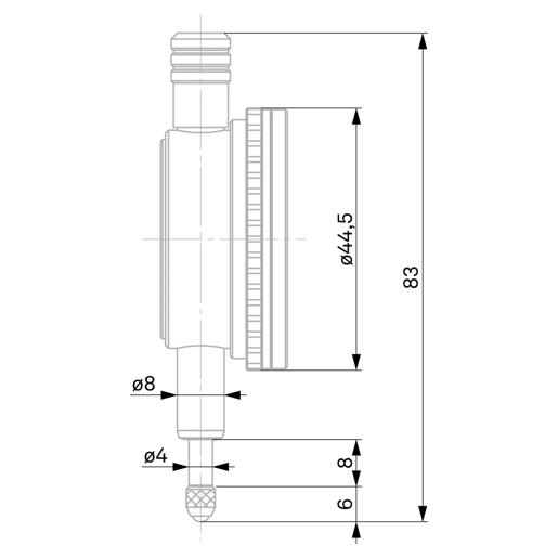

| Mounting shank Ø | 8 mm |
| Shockproof Mechanism | Yes |
| Standard |
Dimensions: EN ISO 463 Performances: Factory standard |
| Dial |
Ø 44.5 mm, rotatable Moving tolerances indexes |
| Reading | Clockwise |
| Circular Scale | 0 - 10 - 20 |
| Colour |
Internal dial: White External dial: Yellow Numerals: Black / Red |
| Material |
Casing: Metallic Mounting Shank: Stainless steel Plunger: Stainless steel |
| Weight | 108 g |
