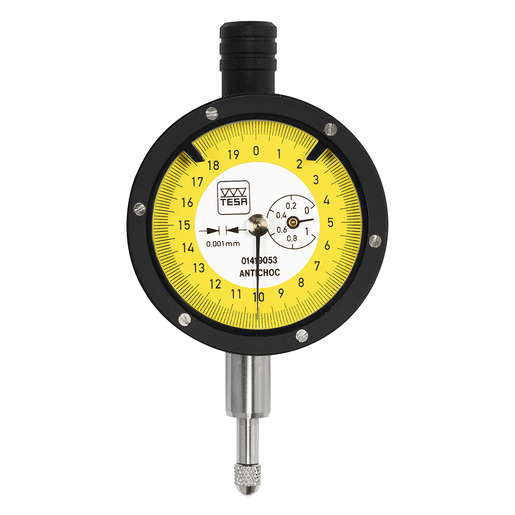

Analogue dial gauge Ø 44.5 mm, protection class IP40. With rotating dial and adjustable tolerance marks. Resolution: 0.001 mm / Measuring range: 1 mm

1x Dial gauge with mounted ball insert Ø 3.175 mm

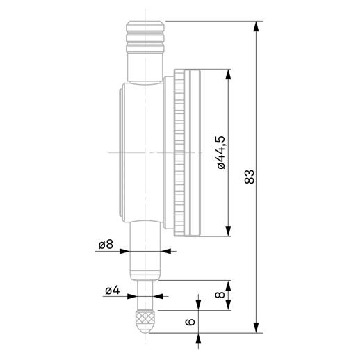

| Insert Thread | M2.5 |
| Mounting shank Ø | 8 mm |

Dimensions: EN ISO 463 Performances: Factory standard |
