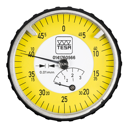

Analogue dial gauge Ø 40 mm, protection class IP40. With rotating dial and adjustable tolerance marks. Resolution: 0.01 mm / Measuring range: 3 mm

| Measurement Technology | Analogue |
| Measuring Unit | mm |
| Measuring Range | 3 mm |
| Resolution | 0.01 mm |
| Travel / Revolution | 0.5 mm |
| Measuring Force | 1.5 N ± 20% |
| MPEe, retractable plunger | 12 µm |
| MPEp, 1 Rotation | 9 µm |
| MPEp, 1/2 Rotation | 8 µm |
| MPEp, 1/10 Rotation | 5 µm |
| MPEr | 3 µm |
| MPEh | 5 µm |
| Protection Class | IP40 |

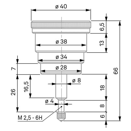

| Insert Thread | M2.5 |
| Mounting shank Ø | 8 mm |
| Shockproof Mechanism | Yes |
| Standard |
Dimensions: EN ISO 463 Performances: Factory standard |
| Dial |
Ø 40 mm, rotatable Moving tolerances indexes |
| Reading | Clockwise |
| Circular Scale | 0 - 25 - 50 |
| Colour |
Internal dial: White External dial: Yellow Numerals: Black |
| Material |
Casing: Metallic Mounting Shank: Stainless steel Plunger: Stainless steel |
| Weight | 140 g |
