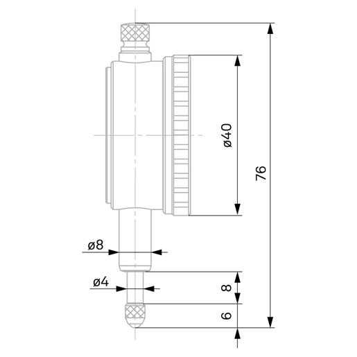

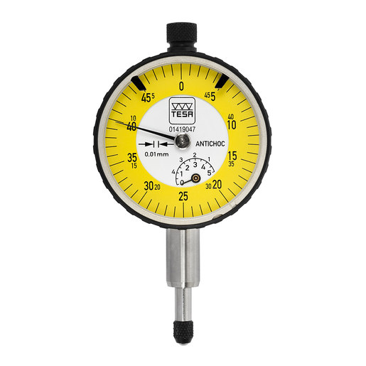

Analogue dial gauge Ø 40 mm, protection class IP40. With rotating dial and adjustable tolerance marks. Resolution 0.01 mm / Measuring range: 5 mm

| Mounting shank Ø | 8 mm |

Dimensions: EN ISO 463 Performances: Factory standard |

Ø 40 mm, rotatable Moving tolerances indexes |
| Reading | Clockwise |
| Circular Scale | 0 - 25 - 50 |
| Colour |
Internal dial: White External dial: Yellow Numerals: Black |
