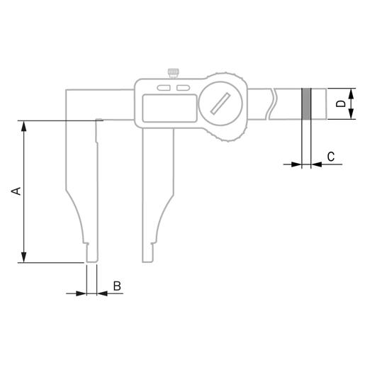

| Dimension (A) | 100 mm |
| Dimension (B) | 8.5 mm |
| Dimension (C) | 4 mm |
| Dimension (D) | 15 mm |
