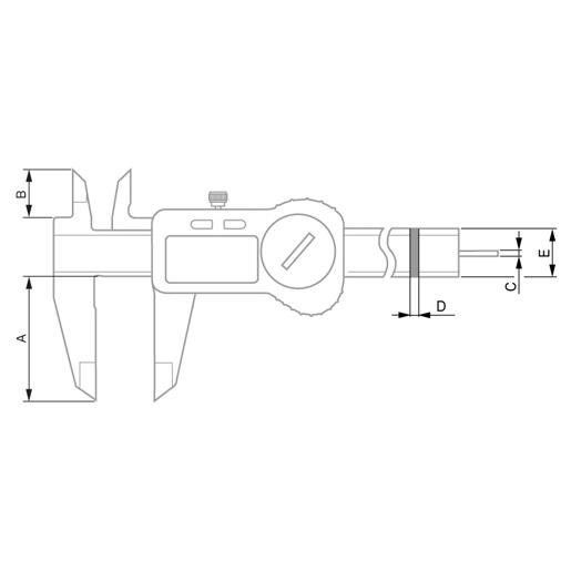

| Locking screw | Yes |
| Dimension (A) | 40 mm |
| Dimension (B) | 16 mm |
| Dimension (C) | 1.3 x 1.8 mm |
| Dimension (D) | 3.2 mm |
| Dimension (E) | 15.5 mm |
