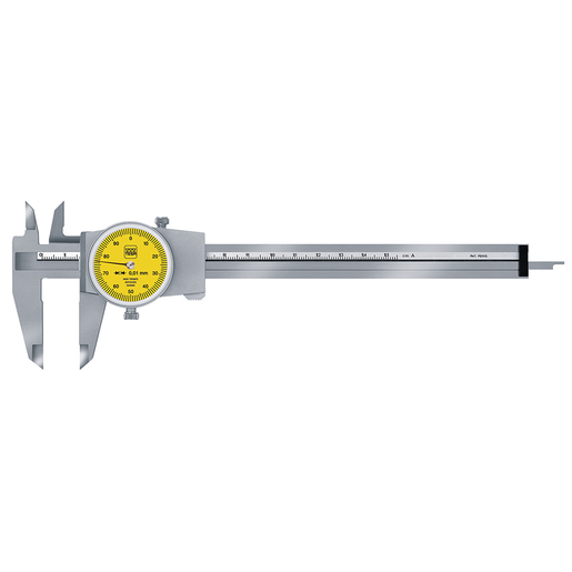

Dial caliper with locking screw and integrated shockproof system. Resolution: 0.01 mm / Measuring range: 0 - 150 mm
Added to your shopping cart.
Instrument
- Perfect operation of the slider for a silky-smooth operation
- Robust construction with housing and protection of the gear mechanism
- Integrated shockproof system guaranteeing longevity and stability of results over time

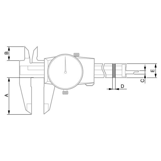

| Dimension (A) | 40 mm |
| Dimension (B) | 13 mm |
| Dimension (C) | 1.5 x 1.8 mm |
| Dimension (D) | 3.2 mm |
| Dimension (E) | 15.5 mm |
