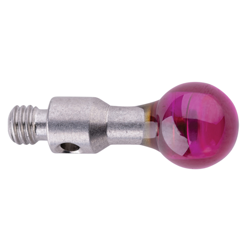

Stylus with M3 thread, ruby ball Ø5 mm, stainless steel stem Ø2.5 mm, length 10 mm. For use with hard contact and touch trigger probes.
Added to your shopping cart.
The stylus is an important part of the measuring system. During the measurement, the stylus is in direct contact with the part.
Straight styli are the most common type used in the metrology industry. Depending on the application, different materials for stems and tips are available.
Ruby is the most widely-used material for styli tips. Thanks to its inexpensive price and high quality, it is the standard choice for most applications. It is an extremely hard material, which tends, however, to cause material build-up when combined with certain materials such as aluminium.
A stainless steel stem provides high stiffness and is ideal where weight is not critical for the application.
| Threa | M3 |
| Tip Material | Ruby |
| Related Device | Absolute Arm |
| Tip Diameter (D) | 5 mm |
| Length (L) | 10 mm |
| Stem Material | Stainless Steel |
| Stem Diameter (S) | 2,5 mm |
| Weight | 2 g |
