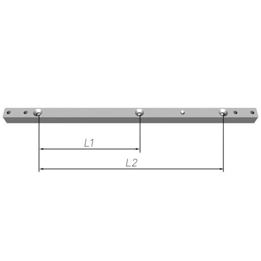

Large-sized certified length bar. Recommended for use with Absolute Arm models of size 3.0 to 4.5 m.
Certified length bars are mainly used to verfiy the accuracy of portable measuring arms and to perform length checkouts. They can also be used to evaluate arm performance against  ISO 10360-12, ASME B89.4.22 or VDI/VDE standards.
This  length bar is recommended for 3.0 to 4.5 m Absolute Arm models.
Indicative Lengths: 514.35 / 1016 mm (20.25" / 40")
Delivery Contents:
1x Length bar
1x Certificate DIN ISO-17025
Recommended Arm Size 3.0 - 4.5 m
Certification DIN ISO-17025
Indicative Length (L1) 514.35 mm
Indicative Length (L1) 20.25 in
Indicative Length (L2) 1,016 mm
Weight 2,890 g
