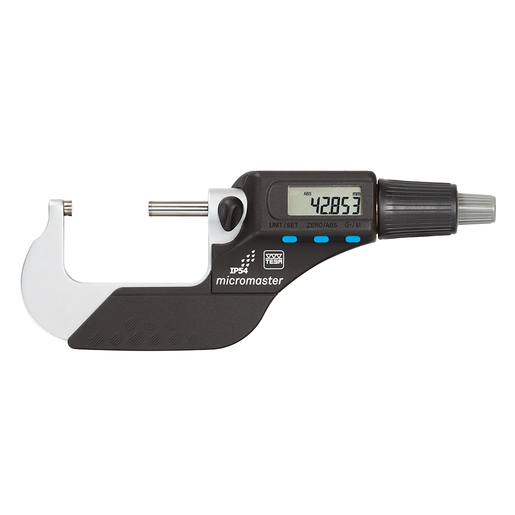

Digital external micrometer with data transmission. Measuring range: 25 - 50 mm / 1 - 2 in
Added to your shopping cart.
Instrument
- Robust construction to ensure long life and stable results
- High degree of protection against liquids and dust
Measurement
- Comfortable reading with large high contrast display
Autonomy
- Long battery life avoiding frequent battery changes
Data Management
- Model with data transmission
Functions
- Standby after 10 min
- Display locking
Delivery contents
1x External Micrometer
1x Battery
1x Measurement report
1x Declaration of conformity
Product Type | External Micrometers |
Measurement Technology | Digital |
Measuring Unit | mm / in |
Measuring Range | 25 - 50 mm / 1 - 2 in |
Resolution | 0.001 mm / .00005 in |
Measuring Force | ≤ 10 N |
Max. perm. Errors | 4 µm |
Max. perm. Parallelism Error | 2 µm |
Protection Class |
IP54 IP40 (with Opto-RS232) |
Thread Pitch | 0.5 mm |
Dimension (A) | 189 mm |
Dimension (B) | 72 mm |
Dimension (C) | Ø 6.5 mm |
Dimension (D) | 26 mm |
Standard | DIN 863 T1 |
Battery | CR2032 |
Autonomy | 2,000 - 4,000 h |
Zero | Floating |
Data Output | Opto-RS232 |
Display | LCD, Digit Size: 7 mm |
Material | Inserts: Tungsten Carbide |
