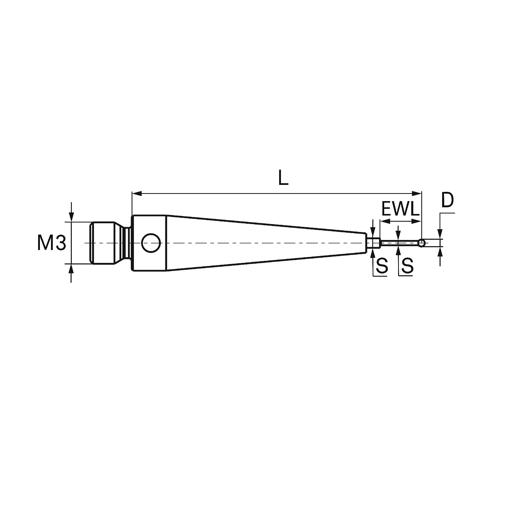

Straight stylus with M3 thread, ruby ball Ø0.5 mm, stepped tungsten carbide stem Ø0.36/0.7 mm, length 21 mm. For use on coordinate measuring machines (CMM).
Added to your shopping cart.
| Similar to Renishaw Code | A-5000-7632 |
| Threa | M3 |
| Related Device | CMM |
| Tip Material | Ruby |
| Tip Diameter (D) | 0.5 mm |
| Ball Grade | G5 |
| Length (L) | 21 mm |
| Eff. Working Length (EWL) | 3 mm |
| Stem Material | Tungsten Carbide |
| Stem Diameter (S) | 0.36 / 0.7 mm |
| Weight | 1 g |
