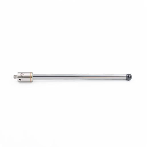

- M5-Stylus (SN-4-TC-3-L118)
ID:
M00-1121-013-000
€146.00
Net price excluding delivery
Quick Overview
Straight stylus with M5 thread, silicon nitride ball Ø4 mm, tungsten carbide stem Ø3 mm, length 118 mm. For use on coordinate measuring machines (CMM).
Added to your shopping cart.
| Threa | M5 |
| Related Device | CMM |
| Tip Material | Silicon Nitride |
| Tip Diameter (D) | 4 mm |
| Ball Grade | G5 |
| Length (L) | 118 mm |
| Eff. Working Length (EWL) | 107 mm |
| Stem Material | Tungsten Carbide |
| Stem Diameter (S) | 3 mm |
| Weight | 22 g |
