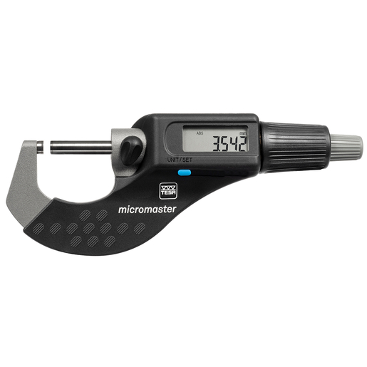

Digital external micrometer without data transmission. Measuring range: 0 - 30 mm / 0 - 1.2 in
Instrument
  • EASY models with simplified functions
  • Robust construction to ensure long life and stable results
  • High degree of protection against liquids and dust

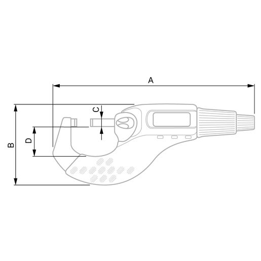

Dimension (A) 163 mm
Dimension (B) 66 mm
Dimension (C) Ø 6.5 mm
Dimension (D) 22 mm
